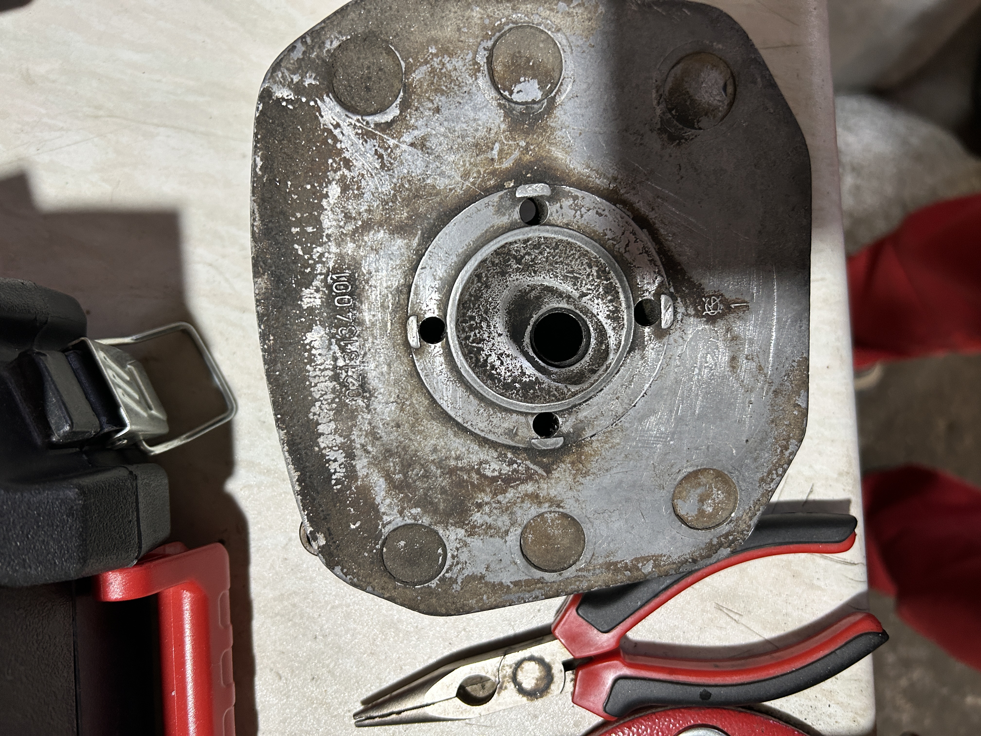

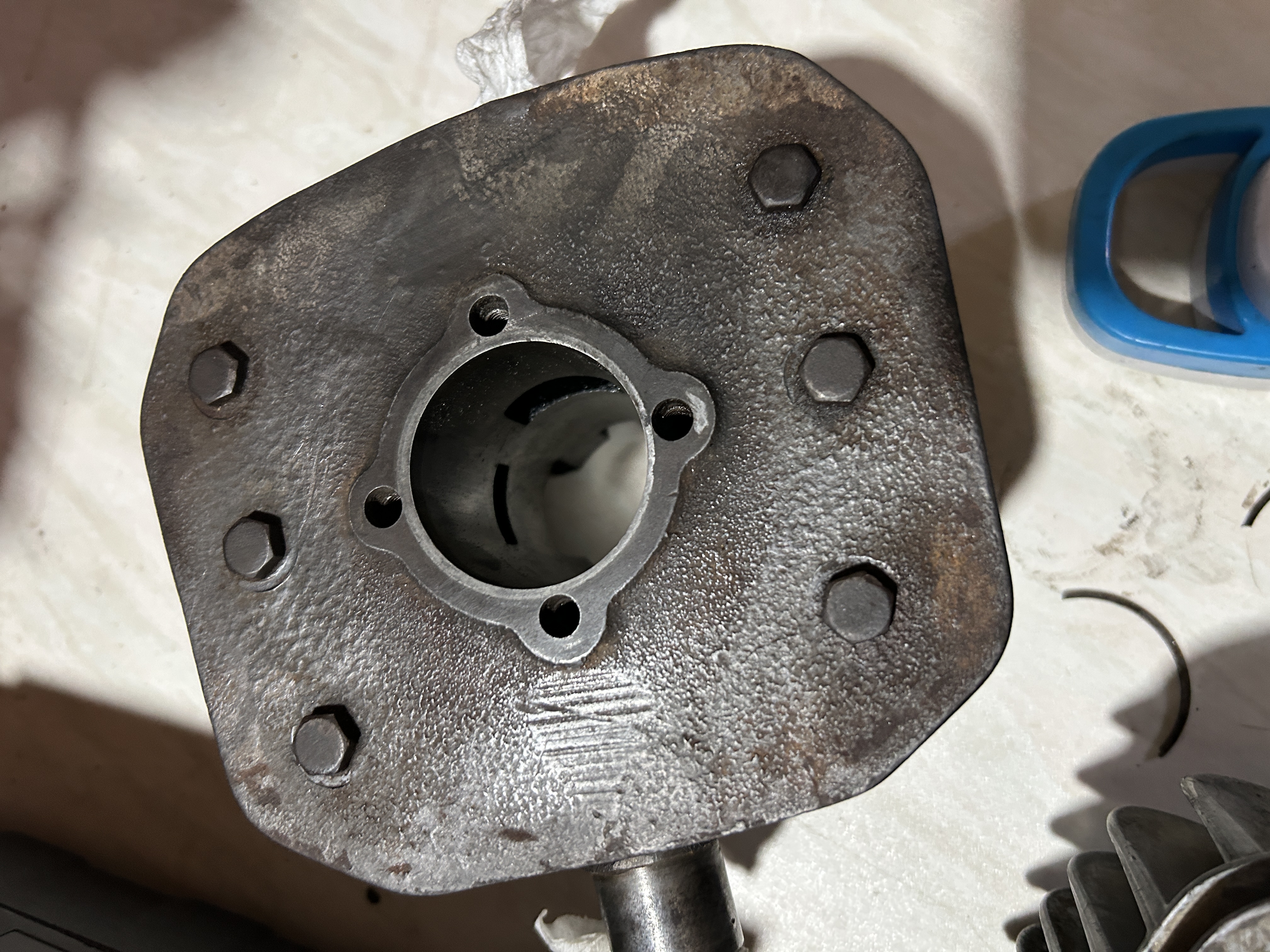

Hallo, i am wondering if anyone knows if i must place cylinder head gasket to my sachs 50cc engine. When i loose the cylinder there were no gaket in the head cylinder.

there should be a nameplate on the engine, what does it say?
Sachs .xyz....
there are engines without head gasket
example
https://wawa-the-duck.lima-city.de/part ... ame001.htm
https://wawa-the-duck.lima-city.de/parts501/main.htm
https://www.lastboy.de/pdf/emot.pdf
sealing surfaces are planned
https://www.youtube.com/watch?v=4WErGyfrArA

Hallo, thank you for the informations, yes is the engine type SACHS 501, and as i can see, no gasket needed. just there must be cleaned area.
